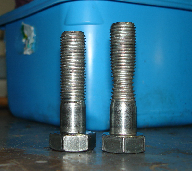

I used CNC machined billet T2024-T3 aircraft aluminum and all new grade 10.9 mounting hardware.
240s weigh a lot less then a 300zx. Brackets designed for a 240 will bolt onto a 300zx but they are not designed to carry nearly as much stress.
My brackets where 2 times as meaty as anything on the market today.
This is what typical 8.8 hardware did for a guy installing another kit:
